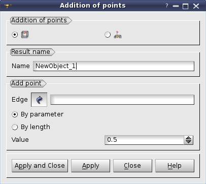

The location of a new vertex on the selected edge can be defined in two ways:
  1. By specifying the position (ranging from 0.0 to 1.0) by length or by parameter.
    TUI Command: geompy.DivideEdge(Shape, EdgeID, Value, IsByParameter)
    • Shape is a shape, which contains an edge to be divided;
    • EdgeID is the ID of the edge to be divided, if it is = -1, then Shape should be an edge itself;
    • Value is a value of parameter on edge or length parameter, depending on IsByParameter;
    • IsByParameter is a boolean flag, specifying the operation mode:
      • True: Value is treated as a curve parameter; [0..1]
      • False: Value is treated as a length parameter. [0..1]
    Arguments: Name + 1 Edge + 1 Value setting the position of the point according to the selected mode.
    The difference between "by parameter" and "by length" modes becomes apparent on the edges with irregular parametrization (for example, b-splines which usually have irregular density by the length). For example, value 0.5 "by length" on such edge will produce the point in the middle of this edge (equidistant from both its ends); the same 0.5 value "by parameter" will result in the point situated closer to one of the ends (depending on the actual parametrization).

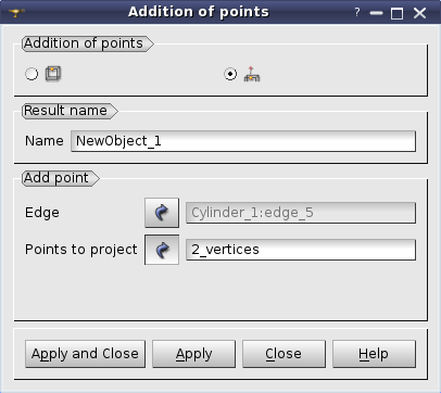

  2. By selecting several points that will be projected to the selected edge to find the location of new vertices.
    TUI Command: geompy.DivideEdgeByPoint(Shape, Edge, Points):
    • Edge is an edge to be divided (or its ID, if it is = -1, then Shape should be an edge itself);
    • Points is a list of points to be projected to the Edge.
    Arguments: Name + 1 Edge + 1 or more Points.
