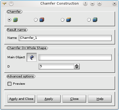

To create chamfer on all edges of the given shape, you need to define the Main Object to create a chamfer on and the Dimension (radius) of the chamfer.
TUI Command: geompy.MakeChamferAll(Shape, D)
Arguments: Name + 1 SHAPE + 1 value (Chamfer dimension).
Advanced options Preview
Chamfer on the whole object

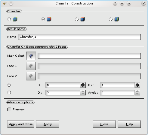

To create chamfer on the specified edges of the given shape, you need to define the Main Object to create a fillet on, select the two faces to which belongs the necessary common edge in the viewer and define the Dimension of the Chamfer.
TUI Command: geompy.MakeChamferEdge(Shape, D1, D2, Face1, Face2), where Shape is a shape to create a chamfer on, D1 is a chamfer size along Face1, D2 is a chamfer size along Face2, Face1 and Face2 are indices of faces in Shape.
Alternative TUI Command: geompy.MakeChamferEdge(Shape, D, Angle, Face1, Face2), where D1 is a chamfer size along Face1 and Angle is the angle between Face1 and the chamfer plane.

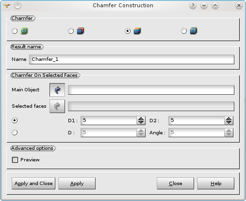

To create chamfer on the specified faces of the given shape, you need to define the Main Object to create a fillet on, select the necessary faces the OCC Viewer and define the Dimension of the Chamfer.
TUI Command: geompy.MakeChamferFaces(Shape, D1, D2, ListOfFaceID), where Shape is a shape to create chamfer on, D1 and D2 are chamfer sizes along faces from ListOfFaceID. For each Edge Face1 and Face2 are defined basing on their indices.
Alternative TUI Command: geompy.MakeChamferFaces(Shape, D, Angle, ListOfFaceID), where D1 is a chamfer size along Face1 and Angle is the angle between Face1 and the chamfer plane.

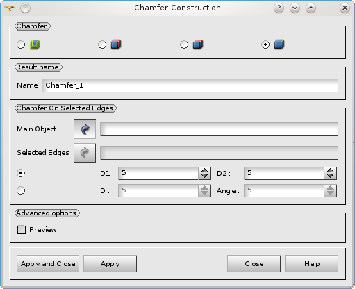

To create chamfer on an arbitrary set of edges of the given shape to define the Main Object to create a fillet on, select the necessary edges the OCC Viewer and define the Dimension of the Chamfer.
TUI Command: geompy.MakeChamferEdges(Shape, D1, D2, ListOfEdgeID), where Shape is a shape to create chamfer on, D1 and D2 are chamfer sizes along faces defined by the algorithm basing on ListOfEdgeID, which is a list of indices of edges in Shape. For each Edge the algorithm selects Face1 and Face2 basing on their indices.
Alternative TUI Command: geompy.MakeChamferEdges(Shape, D, Angle, ListOfEdgeID), where D1 is a chamfer size along Face1 and Angle is the angle between Face1 and the chamfer plane.
