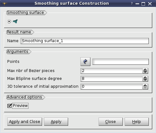

To create a Smoothing Surface in the Main Menu select New Entity - > Advanced - > SmoothingSurface
In this dialog you can specify the following parameters:
  • Name of the surface;
  • the list of Points or compounds of points, from which it is approximated;
  • Max nbr of Bezier pieces in the resulting surface;
  • Max BSpline surface degree of the resulting BSpline surface;
  • 3D tolerance of initial approximation
Note
3D tolerance of the initial approximation represents the tolerance of initial plate surface approximation. If this parameter is equal to 0 (default), its value is automatically computed as max(0.0001, 10*error), where error is the 3D tolerance of the surface representing the maximal distance between the computed plate surface and given points.
Advanced options: Preview
Press "Apply" or "Apply & Close" button to get the resulting GEOM_Object(Surface).
