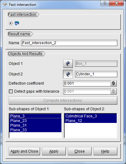

In this dialog:
  • Object 1 and Object 2 the checked objects. Selection button allows picking them in the viewer or in the object browser.
  • Deflection coefficient specifies the quality of shapes tessellation.
  • Detect gaps - when switched on, allows detecting gaps between shapes.
  • Tolerance - specifies the distance between shapes used for detecting gaps.
  • Compute intersections - press this button to compute interferences.
  • Sub-shapes of Object 1 - list of sub-shapes from the first source shape that localize the intersection.
  • Sub-shapes of Object 2 - list of sub-shapes from the second source shape that localize the intersection.
  • Apply and Apply and Close buttons are used to store selected intersected shapes in the study for further analysis (see below).
