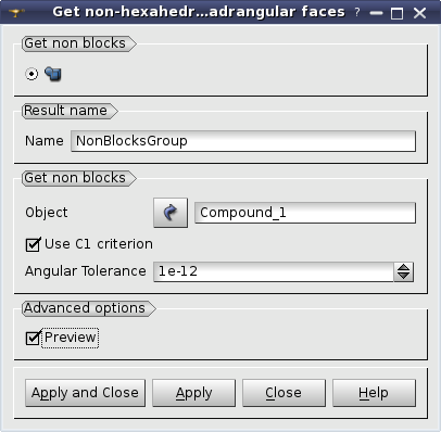

It is possible to select an Object to be explored, to check or uncheck Use C1 criterion option and to set the Angular Tolerance to check C1 continuity between neighbor edges in a wire.
Preview option shows non-block solids and non-quadrangular faces in the viewer.
Press Apply or Apply and Close button to publish non-block solids and non-quadrangular faces in the Object Browser under the processed object. Solids and faces are published separately in two groups.
