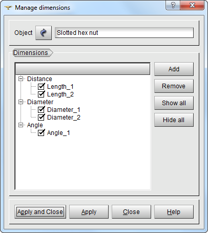

List of Dimensions
This dialog provides the list of dimensions shown in the view for the selected geometrical Object. The list items are sorted by dimension type: Distance, Diameter and Angle.
It is possible to show/hide a dimension in the view by checking on/off the box to the left of its name.
The buttons to the right of the list provide the following operations:
  • "Add" - opens "Add Dimension" dialog to define a new fly-out.
  • "Remove" - removes the selected item from the list.
  • "Show All" / "Hide All" - shows/hides all dimensions existing in the list.

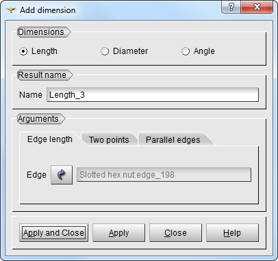

Add a Dimension
To add a new dimension to the object presentation, click Add button in the Manage Dimensions dialog.

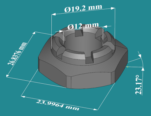

The following dimensions can be shown:
  • Length. There are three possible types of length dimensions:
    • Edge length - shows the length of the edge selected in the viewer. Only line edges, i.e. line segments built on two points are accepted.
    • Two points - shows the distance between two points selected in the viewer.
    • Parallel edges - shows the distance between two parallel line edges.
  • Diameter of an an arc, a circular edge or face, a sphere, a cylinder, a cone or a torus.
  • Angle. The angle dimension can be defined in one of two possible ways :
    • By selecting Two edges located in the same plane.
    • By selecting Three points. The second point is in the corner of the angle.

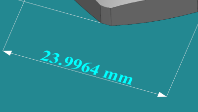

It is also possible to change the geometrical properties of the selected dimension interactively in the viewer.
When hovering with mouse, the text and line become highlighted, which means that the dimension is ready for interactive operations.
The following operations are possible:
  • To change the fly-out of a dimension text without changing its plane (direction), drag it by mouse with left mouse button pressed.
  • To change both the fly-out and the plane (direction) of a dimension text, drag the flyout by mouse with both ctrl key and additionally enables modification of the flyout plane.
  • To modify the location of the dimension text correspondingly to the dimension line, drag it by mouse. The text can be aligned horizontally or vertically and located on the line, under it or in its center.
