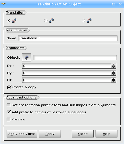

Firstly you can define the Vector by coordinates along the axes.
TUI Command: geompy.MakeTranslation(Shape, DX, DY, DZ), where Shape is a shape to be translated, DX, DY, DZ are components of translation vector.
Arguments: Name + one or several objects + 3 values (coordinates).

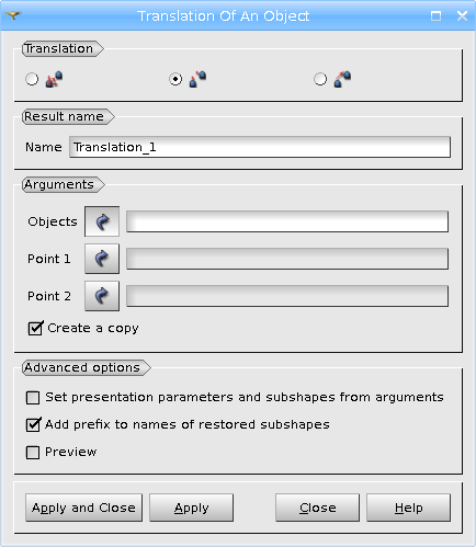

Secondly you can define the Vector by the start and the end points.
TUI Command: geompy.MakeTranslationTwoPoints(Object, Point1, Point2)
Arguments: Name + one or several objects + 2 vertices

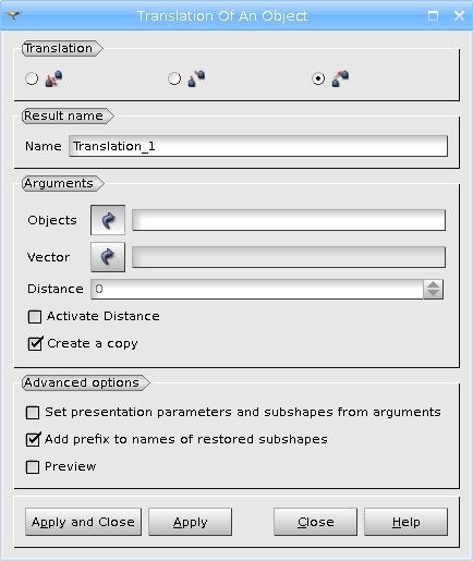

Finally you can define the Vector explicitly. The Object will be translated by the length of the vector. If a curve has been selected instead of the vector, only its first and last vertices will be used to get the vector direction and the dialog preview will display the vector along which the object will be translated.
Activate Distance checkbox and Distance field allow defining a custom distance of translation.
TUI Command: for translation by vector: geompy.MakeTranslationVector(Object, Vector)
TUI Command for translation by vector and a custom distance: geompy.MakeTranslationVectorDistance(Object, Vector, Distance)
Arguments: Name + one or several objects + 1 vector.
