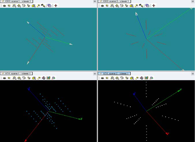

Node generation process follows four steps:
  1. generate all the nodes corresponding to the vertices of the model
  2. generate all the nodes corresponding to the edges of the model
  3. generate all the nodes corresponding to the faces of the model
  4. generate all the nodes corresponding to the blocks of the model
The nodes generated by the meshing of the edges are determined by the discretization law associate to this edge. The coordinates of these nodes are computed on the geometric edges series associate to this edge. To do so/ a curvilinear abscissa is calculated and based on total length of the 1D geometry associate. The geometric modeler (GEOM of SALOME or CasCade) enables to compute this length.

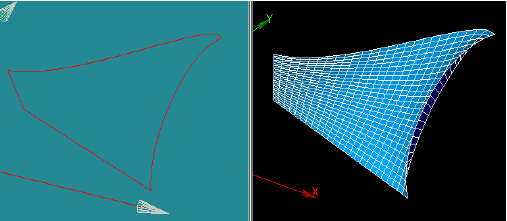

The nodes that are generated by meshing of faces are computed in two stages: 1. meshing by linear approximation 2. refining by projection on the geometry if this geometry exists.
The meshing by linear approximation performs the three following calculations:
  • computation of node coordinates according to the i direction taking into account the discretization law on the j direction
  • computation of node coordinates according to the j direction taking into account the discretization law on the i direction
  • the node coordinates are the coordinates of the midpoint of the segment that is formed from the two previous points
  • if there is a projection step, then the normal at this node is computed
The computation of the normal at a node (i,j) is performed thanks to the neighbor nodes:
  • computation of the plan passing through this node and orthogonal to the straight line connecting the nodes (i-1,j) and (i,j+1)
  • the normal passing through the intersection of the two previous plans
If the node belongs to a border, the node itself is taken to build the line determining the plan which is perpendicular to it.
If there is a geometric face (or a list of faces) associate to one face of the model, then an additional projection step (taking into account the normal to the node of the previous step) is computed in order to obtain a node on the geometric face. The coordinates of this node are computed using the intersection of the normal with this face (or this list of faces).

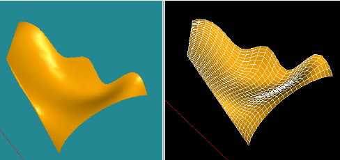

Examples
Linear approximation of the discretization of faces
_images/meshing1.png

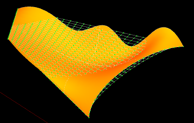

Geometric face and meshing by approximation
_images/meshing2.png
Geometric face and meshing by approximation and projection
