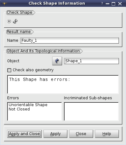

This operation checks the topology of the selected geometrical object and returns True if it is valid.
In this dialog:
  • Object - the checked object. Selection button allows picking it in the viewer or in the object browser.
  • Check also geometry option allows testing the geometry of the object as well.
  • If Exact check of edge tolerances is checked, exact calculation of gaps between curves of edges and surfaces of faces will be performed. If maximum deviation exceeds tolerance of edge, the shape reported as invalid. It takes more time, but gives better results.
  • Errors list informs of possible errors.
  • Incriminated Sub-shapes field outputs the list of sub-shapes that cause problem. It is possible to select them in the list and publish in the study for further analysis by clicking Apply or Apply and Close button.
