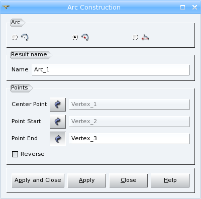

Secondly, you can define an Arc by Center, Start and End points. The arc is built from the Start point to the End point. The radius of the arc is defined by the distance between the Center point and the Start point. The End point defines the angle of the arc. If the distance between the Center point and the End point is not equal to the radius, the arc will be built anyway.
Reverse radio button allows to change the direction of the arc.
TUI Command: geompy.MakeArcCenter(Center Point, Start Point, End Point, boolean Sense)
Arguments: Name + 3 vertices + Boolean.

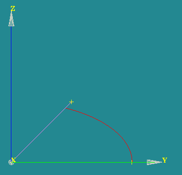

Examples:
Arc by three points lying on it.
Arc by Start, End and Center.
Reversed arc.
Arc Of Ellipse.
