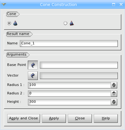

Firstly, you can define a Cone by the Base Point (the central point of the cone base), the Axis, the Height and the first and the second Radiuses.
TUI Command: geompy.MakeCone(Point, Axis, Radius1, Radius2, height)
Arguments: Name + 1 vertex + 1 vector (for direction) + 3 values (Radius of the base part, radius of the upper part, height).

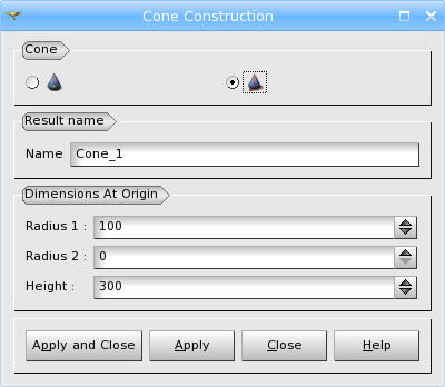

Secondly, you can define a Cone with the center at the origin of coordinates by its Height and Radiuses. The Axis of the Cone will be collinear to the OZ axis of the coordinate system.
TUI Command: geompy.MakeConeR1R2H(Radius1, Radius2, Height)
Arguments: Name + 3 values (Radius of the base part, radius of the upper part, height).
