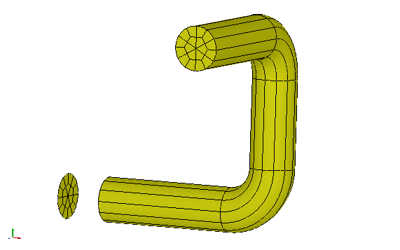

Moreover, this shape can be used as a basis in an Extrusion along a path operation in order to obtain any tube shape prepared for hexahedral meshing (see example below). (Another alternative is to create a 2D mesh on the divided disk and create a 3D mesh by extrusion in the SMESH module.)
Example:

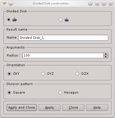

At first it is possible to define a disk by its radius and orientation (plane "OXY", "OYZ" or "OZX"). The resulting disk is located at the origin of coordinates
TUI Command: geompy.MakeDividedDisk(Radius, Orientation, Pattern)
Arguments:
  • Radius - Radius of the disk
  • Orientation - Plane on which the disk will be built
  • Pattern - Division pattern

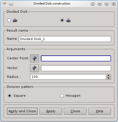

At second the disk can be defined by its center, normal and radius.
TUI Command: geompy.MakeDividedDiskPntVecR(Center, Vector, Radius, Pattern)
Arguments:
  • Center - Center of the disk
  • Vector - Normal to the plane of the disk
