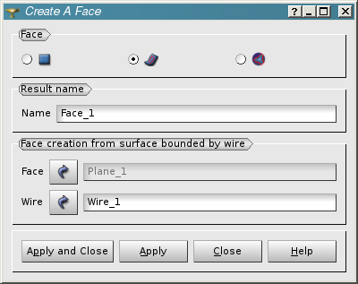

Secondly, it is possible to create a face based on another face's surface and bounded by a wire.
The Result will be a GEOM_Object (face).
TUI Command: geompy.MakeFaceFromSurface(theFace, theWire)
Arguments: Name + 1 face + 1 wire.
Create face by another face's surface

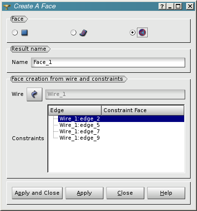

Thirdly, it is possible to create a Face by specifying a set of edges forming a closed wire and constraints:
  • Specify an input wire by selecting it in the object browser or in the viewer. The input wire will be exploded on edges which will be shown in the Constraints list box.
  • Specify constraints by associating faces with the edges.
Note
Please note, that the constraint face must be connected to a reference edge.
TUI Command: geompy.MakeFaceWithConstraints([List of constraints])
Arguments: Name + List of input edges and constraint faces. If a constraint face is missing for some edge, this means that there is no constraint associated to this edge.
Note
Set of edges should form a closed wire.
Create face by a wire and its constraints
