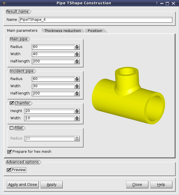

The dialog for definition of PipeTShape parameters and options is split into three tabs.
Main parameters:
  • Main pipe - allows defining the internal Radius, the Thickness and the Half-length (the distance between the end of the main pipe and the central axis of the incident pipe; the incident pipe is always located in the middle of the main pipe) for the main pipe.
  • Incident pipe - allows defining the internal Radius, the Thickness and the Length (the distance between the end of incident pipe and the central axis of the main pipe) for the incident pipe.
  • Chamfer - allows creating a chamfer at the junction of the main and the incident pipes. Its parameters are Height along the incident pipe and Width along the main pipe.
  • Fillet - allows creating a fillet at the junction of the main and the incident pipes by defining the fillet Radius.
  • HexMesh - checkbox allows splitting the shape into blocks suitable for hexahedral mesh.

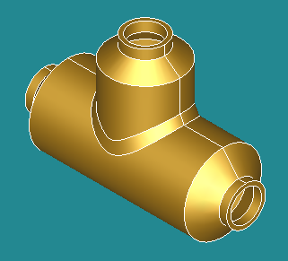

Thickness reduction
This tab allows applying, if necessary, thickness reductions at the open ends of the T-shape pipe (two ends of the main pipe and one end of the incident pipe). For each end it is possible to define:
  • Radius - is the radius of the reduced pipe.
  • Width - is the width of the reduced pipe.
  • Transition length - is the length of transition between the pipe and the reduced pipe.
  • Thin part length is the length of the reduced pipe.

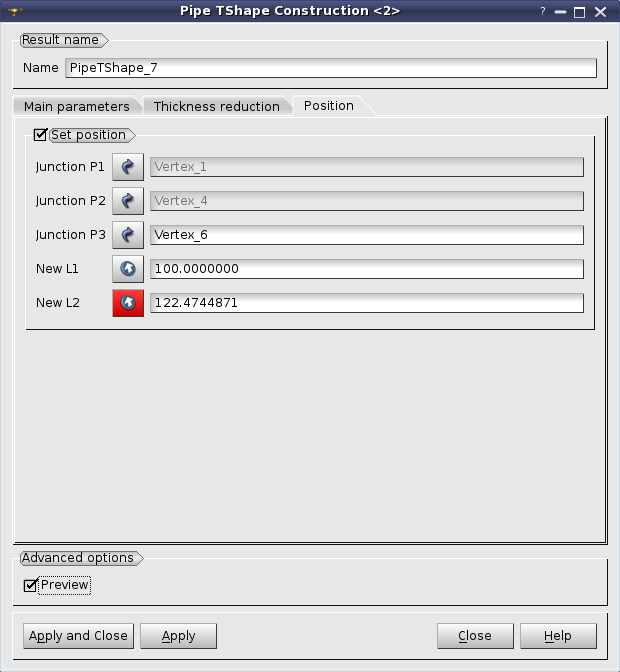

Position
By default the PipeTShape is created at the center of coordinates and oriented by XY (main pipe) and XZ (incident pipe) axes, but it is possible to define a custom Position.
  • Junction P1 and Junction P2 - are the end points of the main pipe (lying on its central axis).
  • Junction P3 - is the end point of the incident pipe.
    The New L1 and New L2 values are calculated automatically, but should be confirmed by clicking the corresponding "Arrow" button.
  • New L1 - is the Half-length of the main pipe.
  • New L2 - is the length of the incident pipe. The Radius and Width of pipes are taken from the Main parameters tab.
