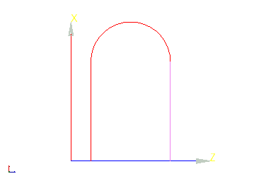

It is possible to create sketches of two types:
  • Profiles made of line segments and arcs, or
  • Rectangles.

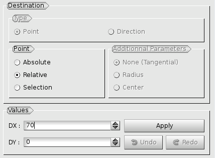

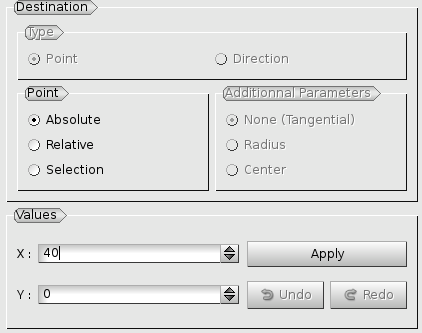

  • Define the start point. By default the start point of the curve is located at the origin of the reference coordinate system. A point in 2D Sketcher can be defined in one of three ways:
    • By Absolute coordinates. Select Absolute radio button in Points group, input X and Y values and click Apply button:
    • By Relative coordinates. Select Relative radio button in Points group, input DX and DY values and click Apply button.

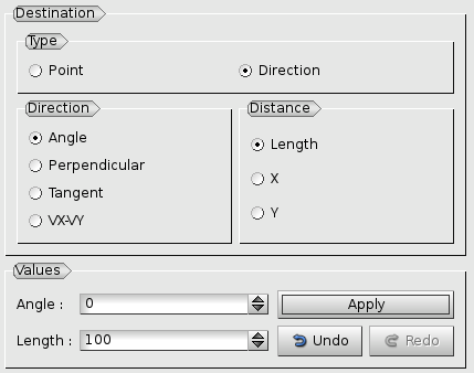

Alternatively to the definition by Points it is possible to define segments by Direction and Distance.
  • The Direction can be:
    • Defined by an Angle to the previous segment.
    • Perpendicular to the previous segment (i.e. the Angle is 90 degrees).
    • Tangent (collinear) to the previous segment (i.e. the Angle is 0 degrees).
    • Defined by VX-VY vector coordinates.
  • The Distance can be defined:
    • By the absolute segment Length
    • By DX - the length of segment projection on X-axis.
    • By DY - the length of segment projection on Y-axis.

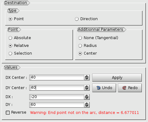

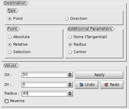

  • By default, None (Tangential) radio button is selected as Additional Parameter, and the arc is tangential to the end of the sketch, which means that it is created on two points as a half-circle with radius equal to a half of the distance between these points.
  • Radius radio-button allows creating a more limited arc segment by defining a custom ark radius, which must be greater than half of the distance between the last point and the end point of the arc.
  • Finally, Center radio-button allows explicitly defining the center of the circle. If an arc segment cannot be built on the defined points, a warning is shown.
