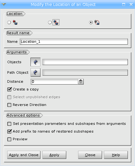

The third algorithm modifies the location of the Object(s) using the Path object (Wire or Edge) and the Distance parameter (ranging from 0 to 1) defining how far the object will move along the path.
Create a copy checkbox allows to keep the initial object, otherwise it will be removed.
Select Unpublished edges checkbox allows to select sub-shape edges on the other objects.
Reverse Direction checkbox allows to REVERSE the direction of the object movement along its path.
Arguments: Name + one or several objects + Translation path.
Advanced options.
