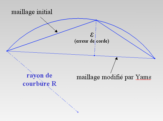

  • Geometrical approximation
    this field as well as the Chordal deviation tolerance parameter,enables the user to bound the maximal chordal deviation allowed. it avoids having sharp angles. , that is, the maximal distance allowed between the detected curve and the plane of the corresponding mesh face. It avoids having faces too far away from the curve they represent.
_images/Tolerance.png
This parameter P enables the user to specify the maximal chordal deviation E relatively to the local curvature. the maximal chordal deviation will be set to E=P x r (r is the radius of the circumcercle) if the units parameter is set to relative or E=P if the units parameter is set to absolute.
