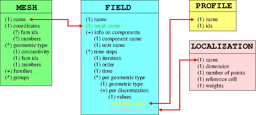

Basics in MED files
First of all MEDLoader will not read MED files whose version is strictly lower than 2.2.
For new comers in MED file world some of basics principles are recalled in the following graphic :
Resumed MED file concepts
Inside the parenthesis, there is multiplicity :
  • + stands for [1,inf)
  • * stands for [0,inf)
  • ? stands for 0 or 1
Each box is independent in MED file format during read/write session.
Boxes instances are linked each other only by red arrows using string as discriminating key.** It implies that empty names in basic concepts objects of MED file are forbidden.
There can be as many instance of boxes as wanted in a MED file.
As it can be seen in MED file world, fields and meshes are sorted by geometric type**.
This specificity leads to a constraint during writing phase because some mesh operations may significantly modify the organization of geometric types during mesh/field operations.
Here are some of operations that can alter the geometric type order of cells:
  • aggregation of meshes
  • aggregation of fields
  • extraction of a part of meshes
  • extraction of a part of fields
  • partial polyhedrization of meshes
  • unpolyhedronization of meshes
