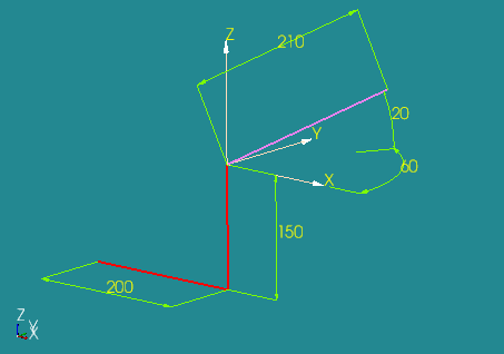

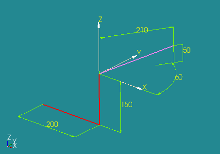

By Angular coordinates, which include:
  • the Length of the segment and an Angle in the chosen plane (OXY for example) in Relative mode. The angle is then relative to a local coordinate system with the last point of the sketch as origin.
  • the Radius (i.e. the distance from the origin) and an Angle in the chosen plane in Absolute mode
In both angular modes you can additionally specify the following:
  • the second Angle (latitude)
  • the Height
