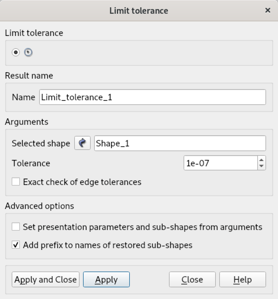

To perform a Limit Tolerance operation in the Main Menu select Repair - > Limit Tolerance.
Arguments: Name + 1 shape + 1 value (new tolerance) + 1 boolean value (exact check).
It is possible on all kind of shapes.
This functionality tries to set a new value of tolerance for the given shape. However, the final tolerance value also depends on the initial shape topology (takes into consideration the existing gaps) to obtain a valid resulting shape. If Exact check of edge tolerances is checked, exact calculation of gaps between curves of edges and surfaces of faces will be performed. It takes more time, but gives better results. Please note, that this gap value will limit the tolerance below, but not above.
