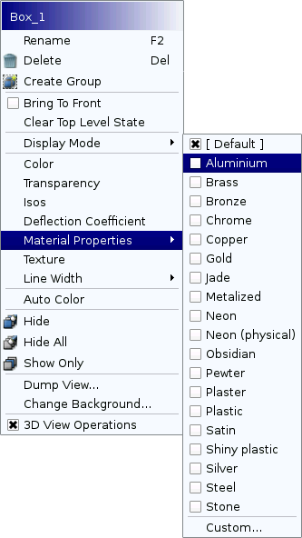

You can change the material properties of the selected shape(s) in the context menu dialog. The layout of context menu can be customized via "Show predefined materials in popup menu" preferences option. If this option is switched off, only "Material properties" item will be shown in the popup menu. If this option is on (by default), "Material properties" item in the popup menu will open a sub-menu with a list of predefined materials:
"Show predefined materials in popup menu" option is switched off
"Show predefined materials in popup menu" option is switched on
The Custom item from this list allows defining Material properties, including the creation of a custom material.

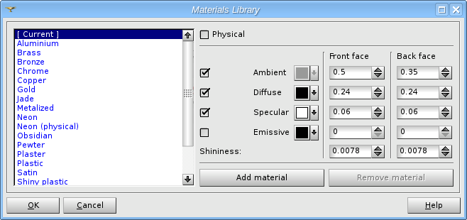

Materials library
The dialog consists of two parts:
  • The list to the left shows all available material models, both predefined and custom.
    • [Current] item in the list corresponds to the material model currently assigned to the selected shape(s). This model can be freely modified by the user.
    • Global material models are shown in blue color in the list; these are the models predefined by the SALOME Geometry module. The user is not allowed to modify the global models.
    • User materials are shown in black color in the list. These models are specified by the user and can be modified at any moment.
  • The widgets to the right allow modifying different properties of the material model:
    • Ambient color and coefficient (floating point value between 0 and 1)
    • Diffuse color and coefficient (floating point value between 0 and 1)
    • Specular color and coefficient (floating point value between 0 and 1)
    • Emissive color and coefficient (floating point value between 0 and 1). Note: this attribute is applicable only for the OCC viewer; it simulates light originating from an object.
    • Shininess
    • Type of material model: physical or artificial.
  • The buttons Add material and Remove material in the lower part of the dialog box can be used to create or remove custom material models. The same commands are also available via the context menu in the materials list. Rename material command can be used to change the name of material model.

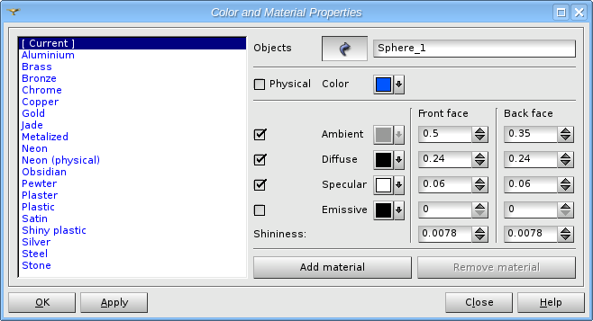

Material properties
In addition to the functionality of Materials library, this dialog provides objects selection mechanism and Color property.
If the material model is specified as a physical (Gold, for example), the shape color (more precisely its ambient color) cannot be modified. If you assign a physical material model to the shape, the "Color" menu item will not be available in the popup menu.
If the model is non-physical (artificial), the color can be changed to any appropriate one, only other attributes will be constant. In the dialog box you will be able to modify the color of the shape via the "Color" button. "Ambient color" button will be disabled to signalize that this attribute of the model is ignored. Also, it will be possible to modify the color of the shape via the corresponding popup menu command.

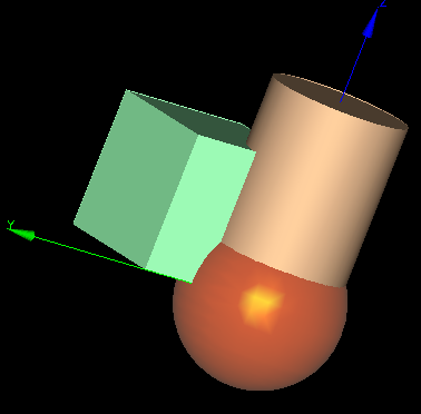

Various materials in OCC viewer
Various materials in VTK viewer
