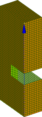

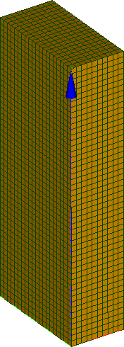

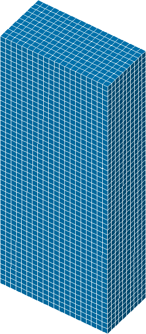

  1. The first step consists in loading the structure mesh (a) as well as the crack surface geometry (b).

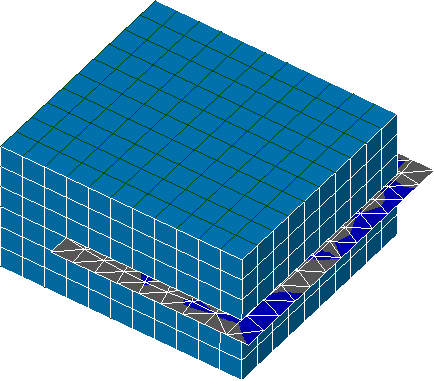

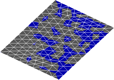

  2. The crack is then meshed (c). A length criterion defines the size of the extracted « Box ». This length is called the length of influence. Every element of the structure mesh having a node within this zone is included in the « Box ». A second operation adds those elements in the Box in order to have continuous faces (d).

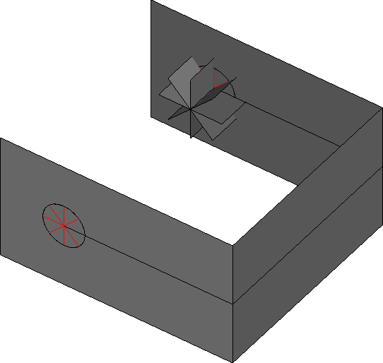

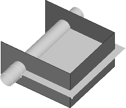

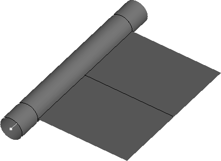

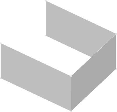

  3. A geometrical Box is reconstructed from the extracted Box mesh. The reconstruction is limited to faces which intersect the crack (e). A torus is created following the crack front (f).
  4. The geometrical Box is then cut by the torus and the crack (g). Several plans are created in order to partition the box and the torus into radiuses for the future mesh (h).

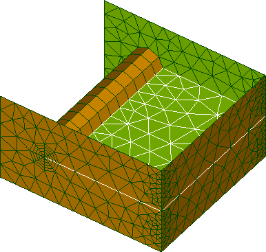

  5. The Box, the crack and the torus are meshed on their external surface (i) and then filled with volumetric elements (j). Crack nodes are doubled to « open » crack lips.

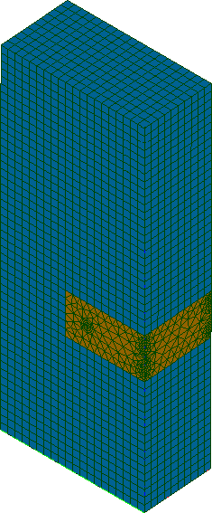

  6. Finally the cracked box mesh is reinserted in the initial mesh ensuring the connectivity (k).

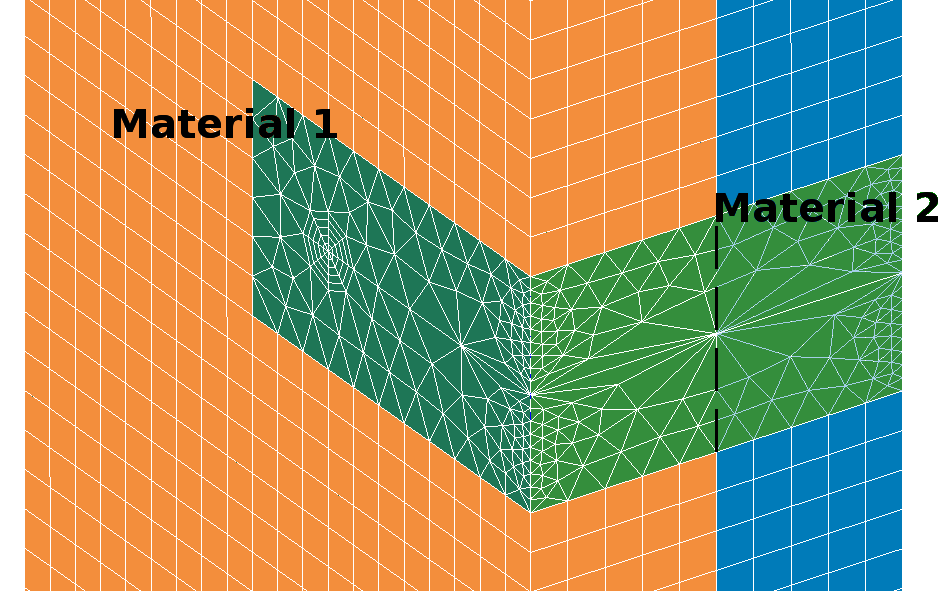

  1. Loss of interfaces:
Interfaces between elements are not kept in the Box zone during insertion. For example, in the case of a crack inserted at an interface between two materials, there is no way to rebuild exactly the original groups for affecting materials properties.
