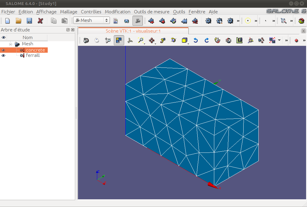

In this example, we consider a concrete piece with a single reinforcement bars group. Thus, two standard (Finite Element type) meshes have been created and published in the study, the first one named “concrete”, and second one named "ferrail", for the steel bars part:

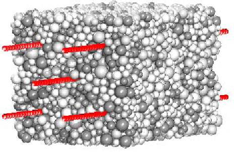

A new functionality has been added to SpherePadder allowing to mesh curved geometries. Circular objects with concave boundaries such as shown here:
can be "padded" with spherical discrete elements. Henceforward, the PointSprite (sphere-like) mode is used to show the MED_BALL elements with their real diameters:

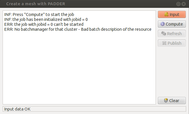

The typical error message when trying to use the padder plugin while the localhost resource is not correctly defined is :
ERR: the job with jobid = 0 can't be started
ERR: No batchmanager for that cluster - Bad batch description of the resource"
This error message is display in the graphical interface of the plugin when you request a computing of your mesh:

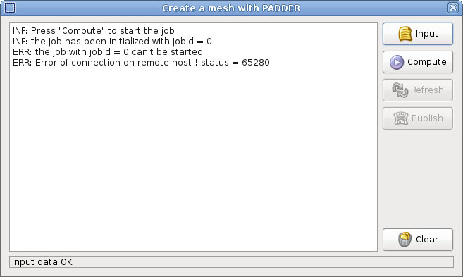

Another typical error when using the padder plugin is due to the ssh configuration between your client host and the execution host:
ERR: Error of connection on remote host ! status = 65280
The underlying batch system for executing padder jobs is based on a ssh communication between the client local host and the execution host (see the protocol specified in the CatalogResources.xml file above), even if the executive host is your local host (i.e. the same as the client host). Then, a ssh connection must be configured so that the underlying batch system could work properly, even between your local host and itself. The configuration could be done using a set of instruction as follow in a shell terminal (see ssh documentation for details):
ssh-keygen
ssh-copy-id -i ~/.ssh/id_rsa.pub <username>@<hostname>
You can check the configuration by testing that you can connect to the host <hostname> with the login <username> without being asked a password:
ssh <username>@<hostname>
