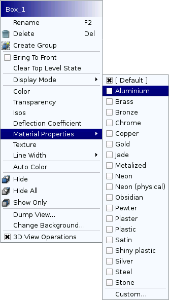

You can change the material properties of the selected shape(s) in the context menu dialog. The layout of context menu can be customized via "Show predefined materials in popup menu" preferences option. If this option is switched off, only "Material properties" item will be shown in the popup menu. If this option is on (by default), "Material properties" item in the popup menu will open a sub-menu with a list of predefined materials:
"Show predefined materials in popup menu" option is switched off
"Show predefined materials in popup menu" option is switched on
The Custom item from this list allows defining Material properties, including the creation of a custom material.

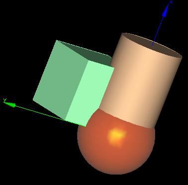

Various materials in OCC viewer

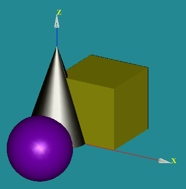

Various materials in VTK viewer
