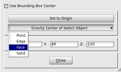

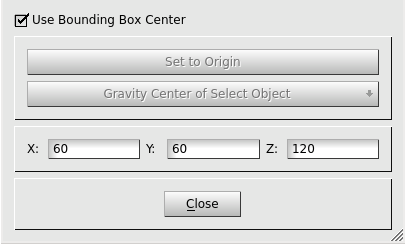

Change rotation point - allows to choose the point around which the rotation is performed.
By default the rotation point is located in the Center of the bounding box of represented objects.
Unchecking Use Bounding Box Center check-box allows you to change rotation point:
Set to Origin button sets the rotation point to origin of coordinates: (0, 0, 0).
Gravity Center of Selected Object button allows using the gravity center of the object selected in the viewer as the center of the rotation point. When you click this button, you should first choose the type of selectable object: Point, Edge, Face or Solid and only then proceed with selection in the viewer.
Also you can define the coordinates of the rotation point manually.

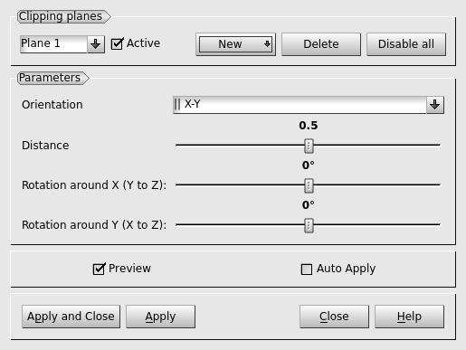

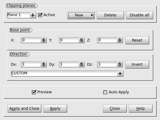

Clipping Planes¶
Clipping allows creating cross-section views (clipping planes) of your mesh.
To create a clipping plane, click on the New button in the dialog and choose how it will be defined by Absolute or Relative coordinates.
Absolute Coordinates
Base point - allows defining the coordinates of the base point for the clipping plane.
Reset - returns the base point to coordinate origin.
Direction - allows defining the orientation of the clipping plane.
Invert - allows selecting, which part of the object will be removed and which will remain after clipping.
Relative mode
Orientation ( ||X-Y, ||X-Z or ||Y-Z).
Distance between the opposite extremities of the boundary box of represented objects, if it is set to 0.5 the boundary box is split in two halves.
Rotation (in angle degrees) around X (Y to Z) and around Y (X to Z) (depending on the chosen Orientation)
The other parameters are available in both modes :
Active checkbox is used to apply/erase current plane and it’s affect to/from view.
Delete removes the active clipping plane and discards it’s view changes.
Disable all deactivates all created clipping planes and clears Auto Apply checkbox.
Preview check-box shows the clipping plane in the 3D Viewer.
Auto Apply check-box allows you to see the result of clipping in the 3D Viewer immediately. Be careful, it is not a preview 2and Close button could not cancel the applied modifications.

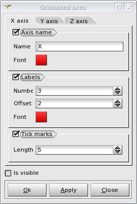

Graduated axes - allows to define axes parameters and graduate them.
Axis name - if checked the axis name is displayed in the viewer.
Name - allows to redefine the axis name.
Font - allows to define the font color of the axis name.
Labels - if checked the labels are displayed in the viewer.
Number - allows to define the number of labels.
Offset - allows to define the distance between axis and labels.
Font - allows to define the font color of labels names.
Tick marks - if checked the tick marks are displayed in the viewer.
Length - allows to define the length of tick marks.
Is visible - if checked the graduated axes are displayed in the viewer.

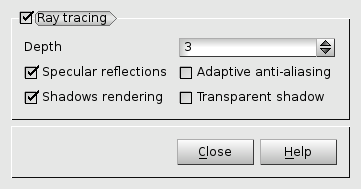

Ray tracing¶
Ray tracing - allows to switch between rendering methods in run-time in the current OCCT 3D view. It can be used to produce images with photorealistic quality.
Ray tracing - specifies rendering mode: OpenGL rasterization (by default) or GPU ray-tracing.
Depth - defines maximum ray-tracing depth.
Specular reflections - enables/disables specular reflections.
Adaptive anti-aliasing - enables/disables adaptive anti-aliasing.
Shadows rendering - enables/disables shadows rendering.
Transparent shadow - enables/disables light propagation through transparent media.

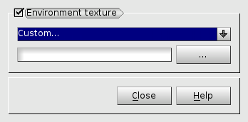

Environment texture¶
Environment texture - allows to set parameters for environment texture. This is a special mode of texture mapping when specular reflection of environment texture is simulated by OpenGL using a special texture coordinates generation algorithm (a sphere map).
Environment texture - enables/disables environment texture in the current OCCT 3D view.
User can select one of 7 predefined environment texture from the list or define its texture from file by choosing item “Custom…” in a combo box.
Note
- Environment texture file should normally satisfy the following requirements in order to produce good visual result:
The image file should have 2:1 width-to-height ratio.
It should constitute a 360-degrees panoramic image created using a fish-eye lens.

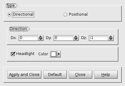

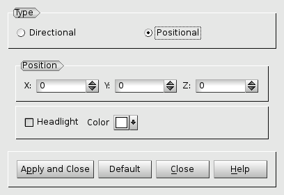

Light source¶
Light source - allows to set parameters for light source.
It’s possible to choose a type of light source between directional and positional light.
Directional light - creates a directional light source in the viewer. It is defined by direction coordinates, color and headlight parameter.
Positional light - creates an isolated light source X,Y,Z in the viewer. It is also defined by the color and headlight parameter.
Click:
Apply and Close to apply defined light source to the OCC 3D Viewer.
Default to restore default values of light source.
Close to return parameters of light source on initial values.
