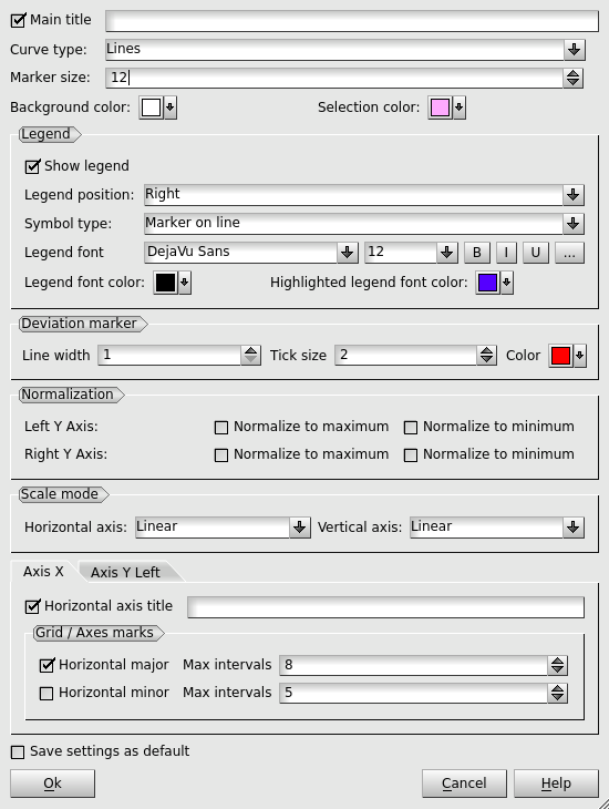

Settings¶
The following options are available:
Main title is the XY plot title. By default, it contains the names of tables, from which the curve lines are constructed.
Curve type allows selecting from Points, Lines or Spline.
Marker size - size of the points (markers) forming curve lines.
Background color of the XY plot.
Selection color - defines the color of selected object in the viewer.
Legend specifies the legend properties.
Show legend - specifies if the legend is shown by default.
Legend Position allows positioning the description table on XY plot (to the Left, to the Right, on Top or on Bottom).
Symbol type allows positioning the legend item symbol: “Marker on line” or “Marker above line”.
Legend font allows setting font variant, size and style for legend items.
Legend font color allows selecting the font color for legend items.
Highlighted legend font color allows selecting font color for selected legend items.
Deviation marker specifies the properties of the marker, which is used for drawing deviations data.
Line width line width of the marker.
Tick size size of the upper and lower horizontal lines of the marker.
Color color of the marker.
Normalization allows selecting the type of normalization (minimum or/and maximum) for the displayed presentations of 2d curves in the view.
Scale mode allows selecting the type of scaling (Linear or Logarithmic) for X (Horizontal) or Y (Vertical) axes separately. Note that the Logarithmic scale can be used only if the minimum value of corresponding component (abscissa or ordinate) of all points displayed in the viewer is greater than zero.
Axis … options group allows specifying additional settings for each axis separately:
Axis title - an axis title.
Grid / Axes marks allows defining the maximum number of major and minor scale divisions for a given axis. The real number of intervals fits to {1,2,5}*10^N, where N is a natural number, and does not exceed the maximum.
Save settings as default If this check box is marked, all XY plots will be displayed with these defined properties.

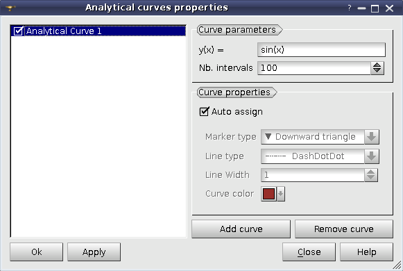

Analytical curves¶
Analytical curves - provides an access to the analytical curves dialog box that allows to add, remove and modify analytical curves for the Plot 2d Viewer.
The options are as follows:
Curve parameters:
y(x)= allows specifying a python expression, which is used to calculate the coordinates of the curve points, where x corresponds to the horizontal range, shown in plot 2D viewer.
Nb. itervals allows specifying the number of the curve points.
Curve properties:
Auto assign if checked, the properties (Line type, Line width, Marker type and Color) are assigned to curves automatically. To define the curve properties manually, uncheck this control.
Line type allows to choose curve line type from None, Solid, Dash, Dot, Dash - Dot and Dash - Dot - Dot.
Line width allows to specify line width of the curve.
Marker type allows to choose curve marker type from Circle, Rectangle, Diamond, Rightward Triangle, Leftward Triangle, Downward Triangle, Upward Triangle, Cross and Diagonal Cross).
Color allows specifying the curve color.
