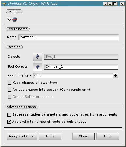

This operation builds a compound by partitioning a set of input objects by a set of tool objects.
The Result of the operation is a GEOM_Object.
Arguments: Name + 2 lists of shapes (the shapes from the first list will be intersected with the shapes from the second list) + Resulting Type of shape.
As far as the partition of two objects can produce any type of geometrical objects, Resulting type box allows choosing the preferable result, i.e. a solid, a shell, a list of faces, etc.
The Resulting type has to be equal or lower than the type of the Objects. In other words, if the Objects don't contain any shape of this type, Partition fails.
Keep shapes of lower type checkbox manages standalone shapes of type other than the Limit. If it is checked, lower dimension objects will be preserved, else they will be lost.
For example, you partition a box (Solid) and a face (Face) without any tool (the box is split in two parts by the shape). If you choose the Resulting Type "Solid", you will obtain a compound of two solids, but if you also check Keep shapes of lower type checkbox, you will obtain a compound of two solids and one face (there will be a hole in the resulting face, where the original face intersects with the box, see the corresponding picture below).
No sub-shapes intersection (Compounds only) check box affects only input shapes of the Compound type.
  • If this option is switched off (default behavior) each input compound will be automatically exploded into sub-shapes and the partition between these shapes will be also computed.
  • If this option is switched on, the partition between sub-shapes will not be performed. In this case the Partition algorithm will work faster, but the result might differ from the default behavior.
Detect Self-intersections check box is used to check self-intersection of arguments. It is enabled only if No sub-shapes intersection (Compounds only) is checked.
  • If this option is switched off (by default), the partition algorithm is performed without self-intersection checks.
  • If this option is switched on, each input shape is checked for self-intersection. If self-intersection is detected, the operation is aborted.
Note
This algorithm does not find all types of self-intersections. It is tuned to detect vertex/vertex, vertex/edge, edge/edge, vertex/face and edge/face interferences. Face/face interference detection is switched off as it is a time-consuming operation that gives an impact on performance. To find all self-intersections please use Detect Self-intersection tool.
Use Fuzzy Parameter check box is used to enable the usage of the fuzzy tolerance inside the partition algorithm. The fuzzy tolerance itself can be given in the Fuzzy Parameter input box.
Note
Partition is a complex operation, so its result of it depends on the quality of the initial shapes. Sometimes, if partition fails, such healing operations as Shape Processing and Limit Tolerance can help to attune source shapes to obtain correct result of the Partition. See also TUI example of shape healing.

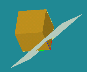

Input data: box intersected by plane
Result: box partitioned by plane
Result: partitioned box and plane (both as Objects); resulting type is Solid; option 'Keep shapes of lower type' is on
