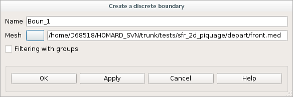

Discrete boundary
The follow-up of a discrete boundary will be made by selecting a boundary chosen in the list of the existing discrete boundaries.
In the starting up, the list is empty. It is necessary to create a first discrete boundary by activation of the button “New”:
_images/create_boundary_di_1.png
The window invites in the choice of a file of mesh. This mesh is the one of all the lines constituting the boundary. A name of boundary is automatically proposed: Boun_1, Boun_2, etc. This name can be modified. It must not already have been used for another boundary, whatever its type.

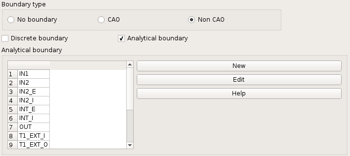

Analytical boundary
In the starting up, SALOME shows a table with one only one column. This column contains the list of all the groups of the initial mesh defining the case.
_images/create_boundary_an_1.png

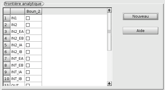

It is necessary to create a first analytical boundary by activation of the button “New”. We shall have the choice between cylinder, sphere, cone or torus. When the boundary will be validated, its name will appear in header of the second column.
_images/create_boundary_an_2.png

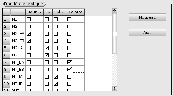

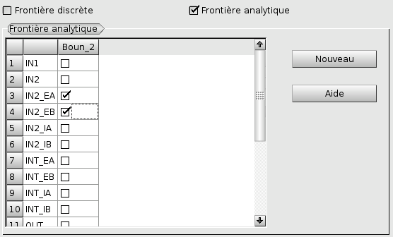

It is now necessary to establish the link enter the mesh defining the case and this boundary described analytically. It is made by checking the groups of the faces which have to be on the boundary.
_images/create_boundary_an_3.png
This operation is repeated as often as we wish to place faces of meshs on a curved surface:
_images/create_boundary_an_4.png
Note
A group can be checked very well never: it means that the elements which it defines belong to none of the described boundaries.
A group can be checked only once. Indeed, surface elements cannot belong to more than one surface.
Several groups can be checked for the same boundary. It occurs if the initial mesh of the zone was subdivided into several groups: all the surface elements belong to this surface but were distributed in several groups.
Conversely, a boundary can be very well retained by no group. It occurs if it was defined for a previous case and if it is groundless for the case in the course of definition.

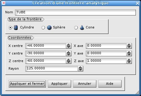

Cylindre
The cylinder is defined by a point of the axis, its axis and its radius. The axis is defined by a vector. The standard of this vector is not inevitably equal to 1; also, its orientation has no importance. A name of boundary is automatically proposed: Boun_1, Boun_2, etc. This name can be modified. It must not already have been used for another boundary, whatever its type.

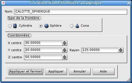

Sphere
The sphere is defined by its center and its radius. A name of boundary is automatically proposed: Boun_1, Boun_2, etc. This name can be modified. It must not already have been used for another boundary, whatever its type.

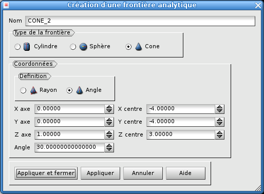

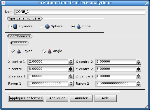

Cone
A cone is defined by two different manners: the center, the axis and the angle of opening in degree or by two points centered on the axis and the associated radius. A name of boundary is automatically proposed: Boun_1, Boun_2, etc. This name can be modified. It must not already have been used for another boundary, whatever its type.
Creation by an origin, an axis and an angle of opening:
_images/create_boundary_an_co_1.png
Creation by two points centered on the axis and the associated radius:
_images/create_boundary_an_co_2.png

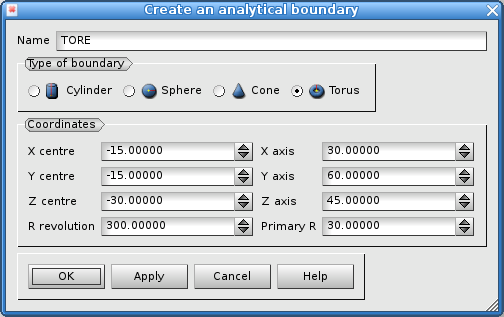

Torus
The torus is defined by its centre, its axis, the revolution radius and the primary radius. The axis is defined by a vector. The standard of this vector is not inevitably equal to 1; also, its orientation has no importance. A name of boundary is automatically proposed: Boun_1, Boun_2, etc. This name can be modified. It must not already have been used for another boundary, whatever its type.
