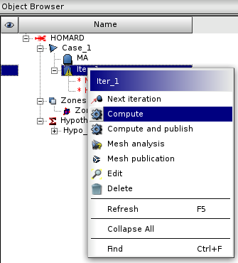

To compute an iteration
To launch an adaptation obtains by selecting the iteration to calculate. It is identified by an icone “wait”. We choose then “Compute” or “Compute and publish” in the menu HOMARD or with the mouse. In the first case, the adaptation is done and the MED files are written down. In the second case, the new mesh will be published into SMESH. Note that if the choice “Compute” was used, the new mesh can be published afterwards, using the choice “Publish”.
_images/lancement_1.png

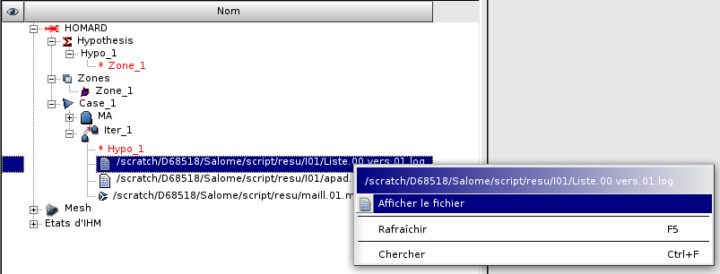

Object browser
At the end of this calculation, the object browser was enriched. The icone in front of the iteration is validated. Under the iteration, we find the reference to the files of results created, identified by their name in the directory rep which was defined in the creation of the case:
  • rep/I(n+1)/Liste.n.vers.(n+1).log
  • rep/I(n+1)/apad.n.vers.(n+1).bilan
  • rep/maill.(n+1).med
The first two files are text files, editable. Liste.n.vers.(n+1).log contains information on the progress of the adaptation: summary of the mode of adaptation, percentage of concerned elements, etc. The file apad.n.vers.(n+1).bilan is a summary of the characteristics of the obtained mesh.
The file maill.(n+1).med is the one which contains the mesh produced in the format MED. If the publication was selected, we find this mesh in the section of the object browser of the module SMESH. It is then visible in this module and usable then as quite different mesh.
_images/lancement_2.png
To consult the result of an adaptation
Both text files, Liste.n.vers.(n+1).log and apad.n.vers.(n+1).bilan, are visible by selecting them. We choose then “Edit file” in the menu HOMARD or with the mouse.
