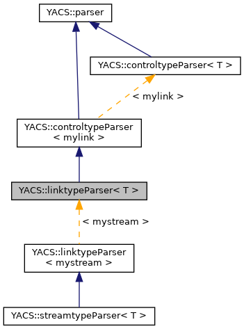

Inheritance diagram for YACS::linktypeParser< T >:

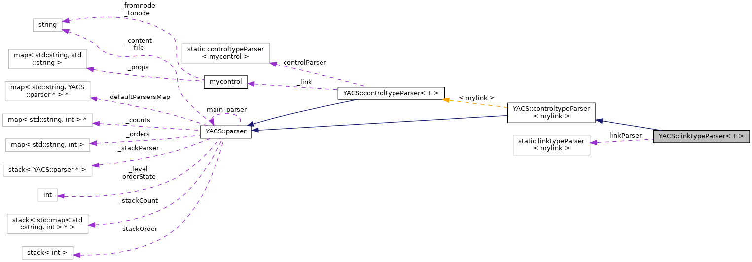

Collaboration diagram for YACS::linktypeParser< T >:
