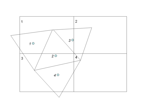

Transfer of a field supported by a quadrangular mesh to a triangular mesh
In the figure above we see the transfer of a field based on a quadrangular mesh to a new field supported by a triangular mesh. In a P0-P0 interpolation, to obtain the value on a triangle, the values on the quadrangles are weighted by their intersection area and summed.

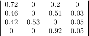

Computing the field on the receiving side can be expressed in terms of a matrix-vector product : $ \phi_t=W.\phi_s$, with $ \phi_t $ the field on the target side and $ \phi_s $ the field on the source side. When remapping a 3D surface to another 3D surface, a projection phase is necessary to match elements from both sides. Care must be taken when defining this projection to obtain a conservative remapping.
In the P0-P0 case, this matrix is a plain rectangular matrix with coefficients equal to the intersection areas between triangle and quadrangles. For instance, in the above figure, the matrix is :
\begin{tabular}{|cccc|}
0.72 & 0 & 0.2 & 0 \\
0.46 & 0 & 0.51 & 0.03\\
0.42 & 0.53 & 0 & 0.05\\
0 & 0 & 0.92 & 0.05 \\
\end{tabular}
