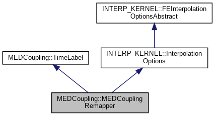

Inheritance diagram for MEDCoupling::MEDCouplingRemapper:
