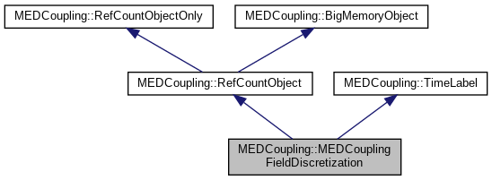

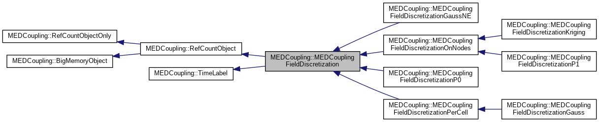

Inheritance diagram for MEDCoupling::MEDCouplingFieldDiscretization:
Collaboration diagram for MEDCoupling::MEDCouplingFieldDiscretization:
