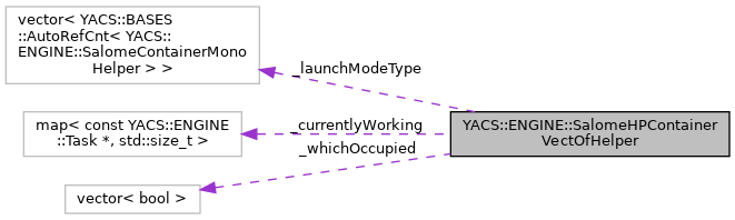

Collaboration diagram for YACS::ENGINE::SalomeHPContainerVectOfHelper:

Private Attributes
std::vector< bool > _whichOccupied
std::vector< BASES::AutoRefCnt< YACS::ENGINE::SalomeContainerMonoHelper > > _launchModeType
std::map< const Task *, std::size_t > _currentlyWorking
