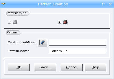

Automatic Pattern Generation¶
To generate a pattern automatically from an existing mesh or sub-mesh, click New button.
The following dialog box will appear:
In this dialog you should specify:
Mesh or Sub-mesh, which is a meshed geometrical face (for a 2D pattern) or a meshed solid block (for a 3D pattern). Mesh nodes lying on the face vertices become key-points of the pattern.
A custom Pattern Name
Additionally, for a 2D pattern you may choose to Project nodes on the face to get node coordinates instead of using “positions on face” generated by the mesher (if there is any). The faces having a seam edge cannot be used for automatic pattern creation.
When a pattern is created from an existing mesh, two cases are possible:
A sub-mesh on a face/solid is selected. The pattern is created from the 2D/3D elements bound to the face/solid by the mesher. For a 2D pattern, the node coordinates are either “positions on face” computed by the mesher, or coordinates got by node projection on a geometrical surface, according to the user choice. For a 3D pattern, the node coordinates correspond to the nodes computed by the mesher.
A mesh, where the main shape is a face/solid, is selected. The pattern is created from all 2D/3D elements in a mesh. In addition, if all mesh elements of a 2D pattern are built by the mesher, the user can select how to get node coordinates, otherwise all nodes are projected on a face surface.
