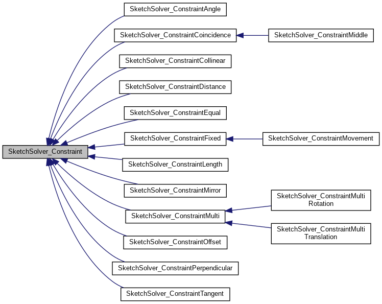

SHAPER 9.16.0
Converts SketchPlugin constraint to the constraint applicable for solver. More...
inlineprotected |
Default constructor.
