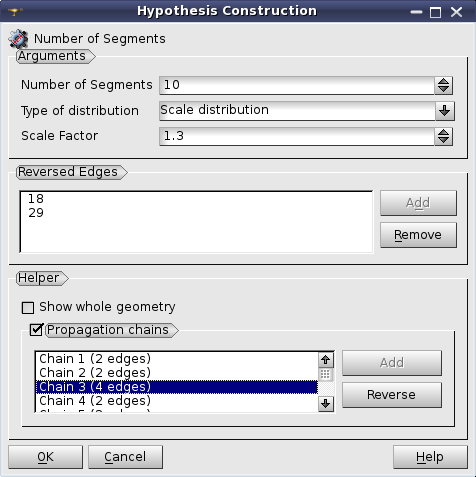

The direction of the splitting is defined by the orientation of the underlying geometrical edge. Reverse Edges list box allows to specify the edges for which the splitting should be made in the direction opposing to their orientation. This list box is enabled only if the geometry object is selected for the meshing. In this case it is possible to select edges to be reversed either by directly picking them in the 3D viewer or by selecting the edges or groups of edges in the Object Browser.
Helper group assists you in defining Reversed Edges parameter.

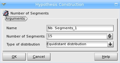

Equidistant Distribution - all segments will have the same length, you define only the Number of Segments.
Scale Distribution - length of segments gradually changes depending on the Scale Factor, which is a ratio of the first segment length to the last segment length.
Length of segments changes in geometric progression with the common ratio (A) depending on the Scale Factor (S) and Number of Segments (N) as follows: A = S(1/(N-1)). For an edge of length L, length of the first segment is L * (1 - A)/(1 - AN)

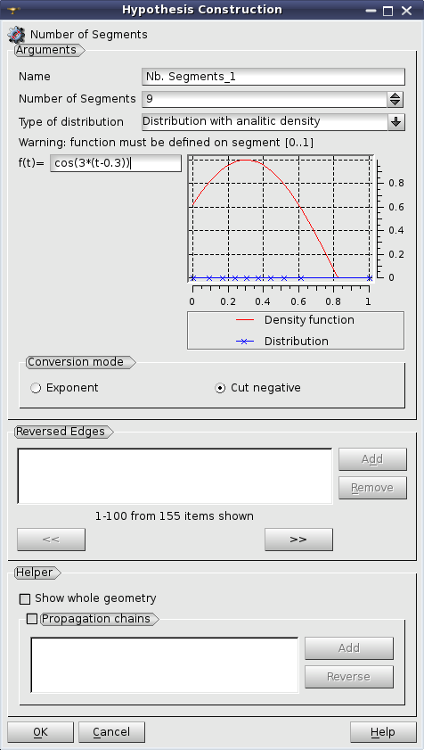

Distribution with Analytic Density - you input the formula, which will rule the change of length of segments and the module shows in the plot the density function curve in red and the node distribution as blue crosses.

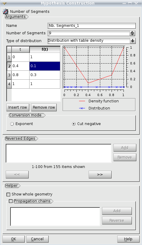

The node distribution is computed so that to have the density function integral on the range between two nodes equal for all segments.
_images/analyticdensity.png
Distribution with Table Density - you input a number of pairs t - F(t), where t ranges from 0 to 1, and the module computes the formula, which will rule the change of length of segments and shows in the plot the density function curve in red and the node distribution as blue crosses. The node distribution is computed in the same way as for Distribution with Analytic Density. You can select the Conversion mode from Exponent and Cut negative.

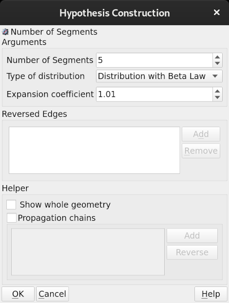

Beta Law Distribution - is given by the following formula (see image below) where t is the position of the point in the segment [0, 1].
_images/nbsegment_beta_law_formula.png
The beta parameter is usually set between 1.01 (narrow mesh) and 1.00001 (very narrow mesh). Values between [-1, 1] are forbidden to ensure validity of the log. Negative values are allowed and result with positions distributed in the opposite direction.
_images/nbsegments_beta_law_dlg.png
Below is an example of Beta Law Distribution for a face that was done using default Expansion coefficient value 1.01.
_images/nbsegments_beta_law_example.png

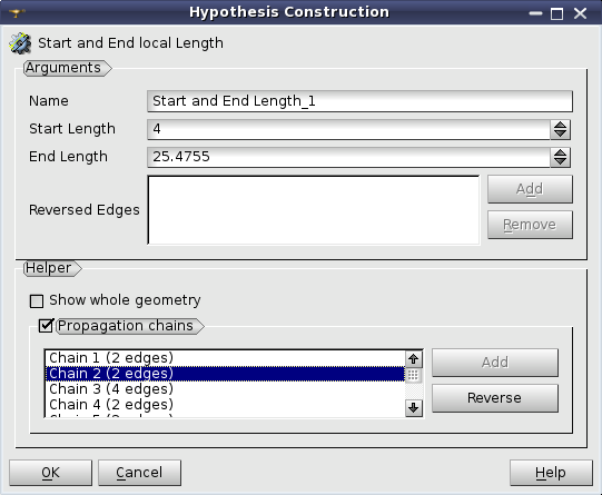

Start and End Length hypothesis allows to divide a geometrical edge into segments so that the first and the last segments have a specified length. The length of medium segments changes with automatically chosen geometric progression.
The direction of the splitting is defined by the orientation of the underlying geometrical edge. Reverse Edges list box allows to specify the edges, for which the splitting should be made in the direction opposing to their orientation. This list box is enabled only if the geometry object is selected for the meshing. In this case it is possible to select edges to be reversed either by directly picking them in the 3D viewer or by selecting the edges or groups of edges in the Object Browser.

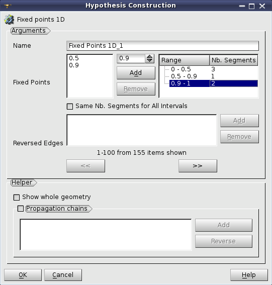

Fixed Points hypothesis allows splitting edges through a set of points parametrized on the edge (from 1 to 0) and a number of segments for each interval limited by the points.
_images/hypo_fixedpnt_dlg.png
It is possible to check in Same Nb. Segments for all intervals option and to define one value for all intervals.
The splitting direction is defined by the orientation of the underlying geometrical edge. Reverse Edges list box allows to specify the edges for which the splitting should be made in the direction opposite to their orientation. This list box is enabled only if the geometrical object is selected for meshing. In this case it is possible to select the edges to be reversed either directly picking them in the 3D viewer or selecting the edges or groups of edges in the Object Browser.
Helper group assists in defining Reversed Edges parameter.

Reversed Edges Helper
_images/rev_edges_helper_dlg.png
Helper group assists in defining Reversed Edges parameter of the hypotheses depending on edge direction.
Show whole geometry check-box allows seeing the whole geometrical model in the 3D Viewer, which can help to understand the location of a set of edges within the model.

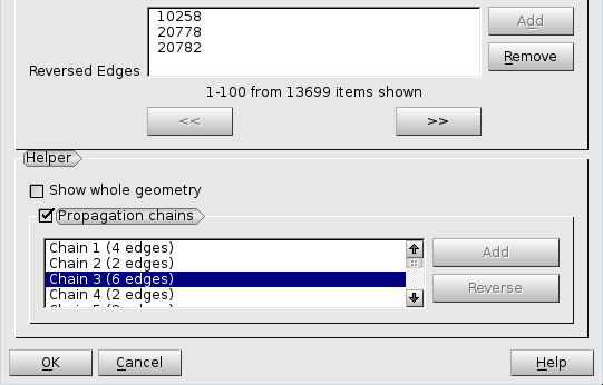

Propagation chains group allows defining Reversed Edges for splitting opposite edges of quadrilateral faces in a logically uniform direction. When this group is activated, the list is filled with propagation chains found within the shape on which a hypothesis is assigned. When a chain is selected in the list its edges are shown in the Viewer with arrows, which enables choosing a common direction for all chain edges. Reverse button inverts the common direction of chain edges. Add button is active if some edges of a chain have a different direction, so you can click Add button to add them to Reversed Edges list.
_images/propagation_chain.png
The whole geometry and a propagation chain
Note
Alternatively, uniform direction of edges of one propagation chain can be achieved by definition of a sub-mesh on one edge of the chain and assigning a Propagation additional hypothesis. Orientation of this edge (and hence of all the rest edges of the chain) can be controlled by using Reversed Edges field.
