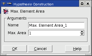

Max Element Area
Max Element Area hypothesis is applied for meshing of faces composing your geometrical object. Definition of this hypothesis consists of setting the maximum area of mesh faces, which will compose the mesh of these faces.
_images/a-maxelarea.png
_images/max_el_area.png
In this example, Max. element area is very small compared to the 1D hypothesis

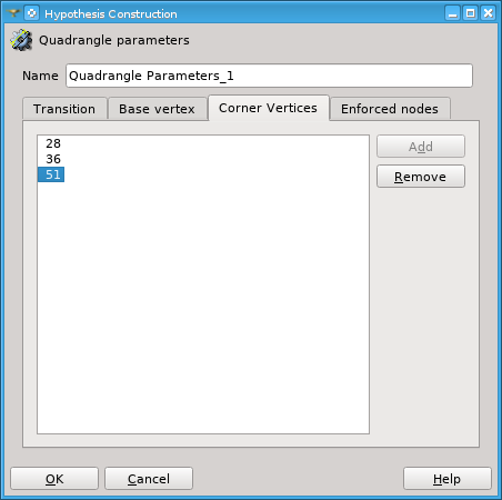

Corner Vertices tab
_images/hypo_quad_params_dialog_corners.png
Quadrangle parameters: Corner Vertices
Corner Vertices tab page allows specifying vertices that should be used as quadrangle corners. This can be useful for faces with more than four vertices, since in some cases Quadrangle Mapping algorithm chooses corner vertices differently than it is desired. Quadrangle parameters hypothesis can be global and define corners for all CAD faces that require it, but be sure that each specified vertex is a corner in all faces the hypothesis will be applied to.

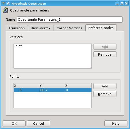

Enforced nodes tab
_images/hypo_quad_params_dialog_enf.png
Quadrangle parameters: Enforced nodes
Enforced nodes tab allows defining points, where the algorithm should create nodes. There are two ways to define positions of the enforced nodes.
  • Vertices group allows to set up shapes whose vertices will define positions of the enforced nodes. Only vertices successfully projected to the meshed face and located close enough to the meshed face will be used to create the enforced nodes.
  • Points group allows to explicitly define coordinates of points used to create the enforced nodes. Only points successfully projected to the meshed face and located close enough to the meshed face will be used to create the enforced nodes.

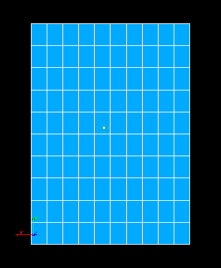

Let us see how the algorithm works:
  • Initially positions of nodes are computed without taking into account the enforced vertex (yellow point).
