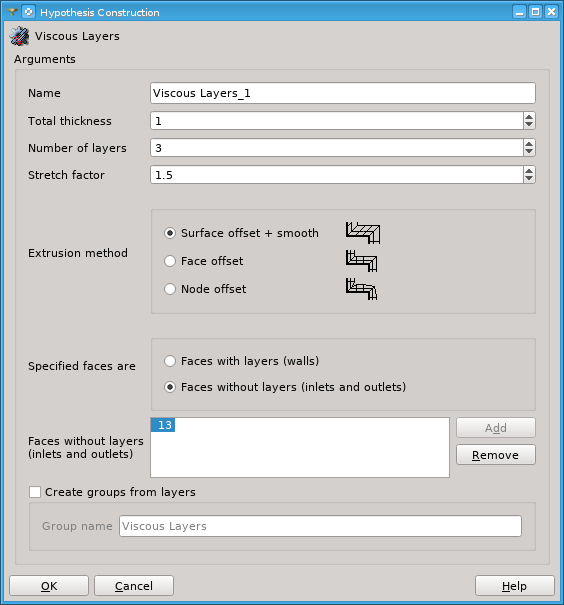

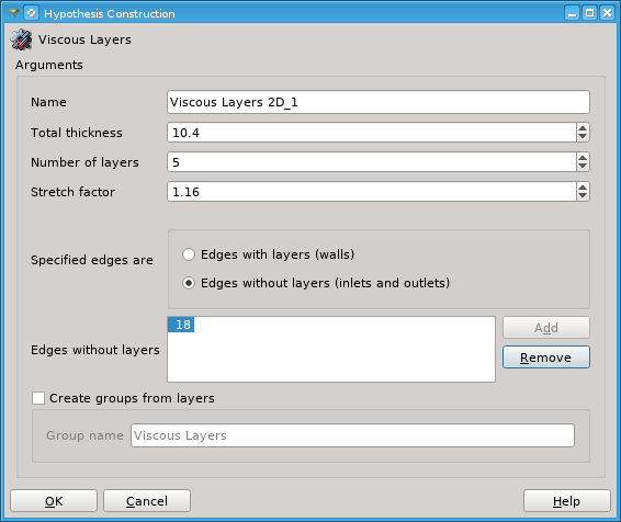

Viscous Layers and Viscous Layers 2D additional hypotheses can be used by several 3D algorithms, for example Hexahedron(i,j,k), or 2D algorithms, for example Triangle (NETGEN_2D), correspondingly. These hypotheses allow creation of layers of highly stretched elements, prisms in 3D and quadrilaterals in 2D, near mesh boundary, which is beneficial for high quality viscous computations.
Name - allows to define the name of the hypothesis.
Total thickness - gives the total thickness of element layers.
Number of layers - defines the number of element layers.
Stretch factor - defines the growth factor of element height from the mesh boundary inwards.

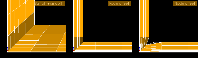

Extrusion method (available in 3D only) - defines how positions of nodes are found during prism construction and how the creation of distorted and intersecting prisms is prevented.
Surface offset + smooth method extrudes nodes along the normal to the underlying geometrical surface. Smoothing of the internal surface of element layers is possible to avoid creation of invalid prisms.
Face offset method extrudes nodes along the average normal of surrounding mesh faces to the intersection with a neighbor mesh face translated along its own normal by the thickness of layers. The thickness of layers can be limited to avoid creation of invalid prisms.
Node offset method extrudes nodes along the average normal of surrounding mesh faces by the thickness of layers. The thickness of layers can be limited to avoid creation of invalid prisms.
Prisms created by the tree extrusion methods at the same other parameters
Specified Faces/Edges are - defines how the shapes specified by the next parameter are used.
Faces/Edges with/without layers - defines geometrical faces or edges on which element layers either should be or should not be constructed, depending on the value of the previous parameter (Specified Faces/Edges are). Faces (or edges) can be selected either in the Object Browser or in the VTK Viewer. Add button becomes active as soon as a suitable sub-shape is selected.
Note
A mesh shown in the 3D Viewer can prevent selection of faces and edges, just hide the mesh to avoid this. If a face, which should be selected, is hidden by other faces, consider creating a group of faces to be selected in the Geometry module. To avoid a long wait when a geometry with many faces (or edges) is displayed, the number of faces (edges) shown at a time is limited by the value of Sub-shapes preview chunk size preference (in Preferences/Mesh/General tab).
If faces/edges without layers are specified, the element layers are not constructed on geometrical faces shared by several solids in 3D case and edges shared by several faces in 2D case. In other words, in this mode the element layers can be constructed on boundary faces and edges only, and are not constructed on internal faces and edges. There is an exception to this rule: if a hypothesis is assigned to a sub-mesh, the element layers can be constructed on boundary faces/edges of the shape of this sub-mesh, at same time possibly being internal faces/edges within the whole model.
Create groups from layers - activates creation of a group containing elements of the layers.
