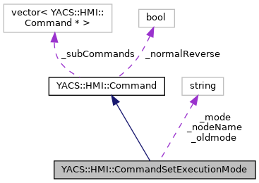

YACS::HMI::CommandSetExecutionMode Class Reference
#include <commandsProc.hxx>
Inheritance diagram for YACS::HMI::CommandSetExecutionMode:
Collaboration diagram for YACS::HMI::CommandSetExecutionMode:
