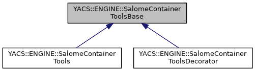

Inheritance diagram for YACS::ENGINE::SalomeContainerToolsBase:
