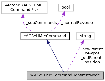

Inheritance diagram for YACS::HMI::CommandReparentNode:
Collaboration diagram for YACS::HMI::CommandReparentNode:
